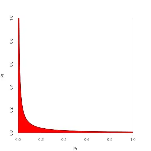

Usually one takes $\alpha = 0.05$ and $s_\alpha$ is given by a quantile of $\chi^2(2n)$. Equivalently, one can work on the product $\prod_i p_i$ which is lower than $e^{-s_\alpha/2}$ with probability $\alpha$. Here is, for $n=2$, a graph showing the rejection zone (in red) (here we use $s_\alpha = 9.49$. The rejection zone has area = 0.05.
Fisher
Now you can chose to work on ${1\over n} \sum_{i=1}^n p_i$ instead, or equivalently on $\sum_i p_i$. You just need to find a threshold $t_\alpha$ such that $\sum p_i$ is below $t_\alpha$ with probability $\alpha$; exact computation $t_\alpha$ is tedious – for $n$ big enough you can rely on central limit theorem; for $n = 2$, $t_\alpha = (2\alpha)^{1\over 2}$. The following graph shows the rejection zone (area = 0.05 again).
sum of p values
As you can imagine, many other shapes for the rejection zone are possibles, and have been proposed. It is not a priori clear which is better – i.e. which has greater power.

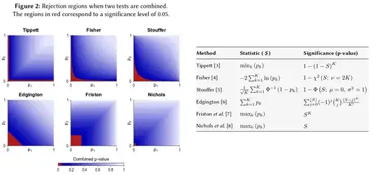

One way to visualize all such methods is to draw rejection regions for $n=2$, as @Elvis did in his nice answer (+1). Here is another figure that explicitly includes Edgington's method from what appears to be a poster Winkler et al (2013) Non-Parametric Combination for Analyses of Multi-Modal Imaging:
Combining p-values
Having said all that, I think there still remains a question of why Edgington's method would (often?) be suboptimal, as follows from it being obscure.
Perhaps one reason for obscurity is that it does not conform to our intuition very well: for $n=2$, if $p_1 = 0.4$ (or higher) then no matter what the value of $p_2$ is, the combined null will not be rejected at $\alpha=0.05$, that is even if e.g. $p_2 = 0.00000001$.
More generally, summing $p$-values hardly distinguishes very small numbers like e.g. $p=0.001$ from $p=0.00000001$, but the difference in these probabilities is actually huge.
