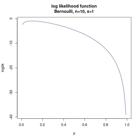

When the procedure you have used to calculate a confidence interval gives an interval including impossible values, that is an indication of problems with the method. In your case, you have used a normal (central limit theorem-based) CI with so few observations that the approximation is invalid. You can test that easily in R, say:
Bernoulli loglikelihood function
We have plotted the loglikelihodd function for your case. If this is (close to) quadratic, the normal approximation will be good. That is clearly not the case here!

R code used for the plot:
make_loglik <- function(n, x) {
     function(p) dbinom(x, n, p, log=TRUE)
loglik <- make_loglik(10, 1)
plot(loglik, from=0, to=1, xlab="p", col="blue", main="log likelihood function\nBernoulli, n=10, x=1")
