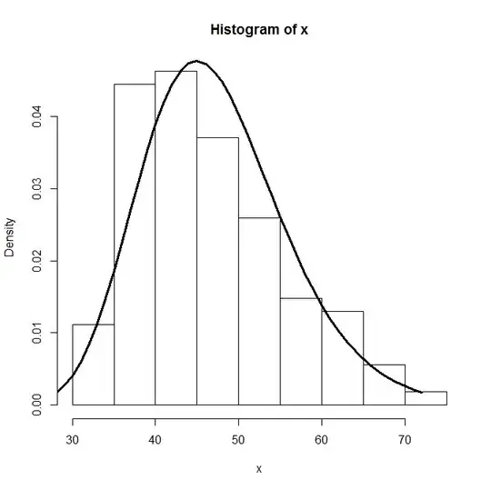

Maybe fitdistr()?
require(MASS)
hist(x, freq=F)
fit<-fitdistr(x,"log-normal")$estimate
lines(dlnorm(0:max(x),fit[1],fit[2]), lwd=3)
> fit
meanlog     sdlog
3.8181643 0.1871289
> dput(x)

Flask
  • 1,931
    Although this solution fits a lognormal to the data, it doesn't tell whether the fit is any good or whether a Pareto is a better choice. – whuber Feb 20 '19 at 14:55
