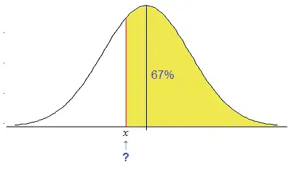

I wish to calculate the value on a normal distribution (having the mean and stdev), where P(Z >= ?) = 67%.
I'm new to stats, so in case my question is unclear, I will draw a picture:

  • @Glen_b I guess the cumulative table. My calculation for the other way around, to get x where P < 0.6664, I'm doing (0.43 * stdev) + mean. I hope that's right; it's doing it as above which eludes me. – Tjorriemorrie Nov 09 '13 at 17:08

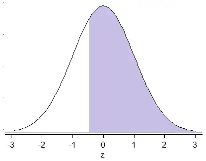

Now that table gives areas like so:
normal curve area, shaded to the left of z
That table doesn't give areas below $0.5$, which correspond to x-values below the mean (negative values of $z$).
You can use the above table to work out an area under the curve to the left of a given value on the x-axis (the z-value for a standard normal), or you can take an area and work out the value on the x-axis that will give that area to the left.
But you want the areas like so:
normal curve area, shaded to the right of z
It would be easy if the left tail areas smaller than $0.5$ were in the table, because then you could take the $z$ value with an area of $1-0.67 = 0.33$ to the left of it, but as I mentioned, they're usually left out of the table (deliberately).
Conveniently, the standard normal distribution is symmetric about zero.
This means that the z-value in the second plot is the negative of the z-value in the first plot.
So if you want to know the z-value with $0.67$ of the area above it, work out the z-value with $0.67$ of the area below it, and then change its sign (in this case, put a "-" sign in front of the z value you look up in the table).
According to my table above, $z = 0.44$ has $0.67$ of the area to the left of (below) it. That means $z = -0.44$ has 0.67 of the area to the right of (above) it.
So then to get the x-value, you multiply by your given standard deviation and add the given mean. So $x=\text{mean} -0.44\times \text{stdev}$ is the x-value that will have 0.67 of the area above it... i.e. such that $P(X>x) = 0.67$
