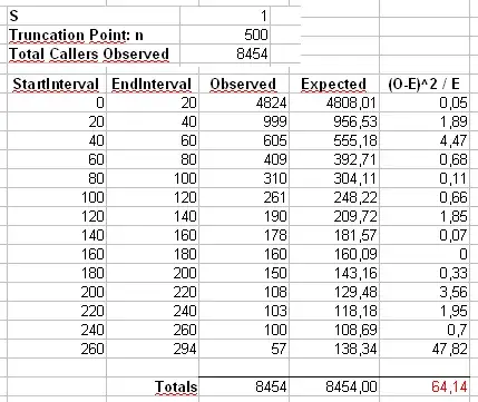

Following the detailed answer of the user cardinal i performed the chi-square test on my presumable truncated zipf distribution. The results of the chi-square test are reported in the following table:
Where the StartInterval and EndInterval represent for example the range of calls and the Observed is the number of callers generating from 0 to 19 calls, and so on.. The chi-square test is good until the last columns are reach, they increase the final calculation, otherwise until that point the "partial" chi-square value was acceptable!
With other tests the result is the same, the last column (or the last 2 columns) always increases the final value and i don't know why and i don't know if (and how) use another validation test.

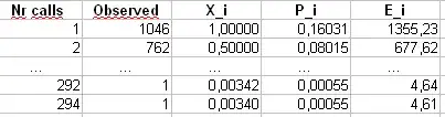

PS: for completeness, to calculate the expected values (Expected) i follow cardinal's suggestion in this way:
where X_i's are used to calculate: x <- (1:n)^-S, the P_i's to calculate p <- x / sum(x) and finally the E_i (Expected nr of users for each nr of calls) is obtained by P_i * Total_Caller_Observed
and with Degree of Freedom=13 the Chi-Square goodness rejects always the Hyphotesis that the sample set follow Zipf Distribution because the Test Statistics (64,14 in this case) is larger than that reported in the chi-square tables, "demerit" for the last column. The graphical result is reported here: enter image description here
although the truncation point is set to 500 the maximum value obtaines is 294. I think that the final "dispersion" is the cause of the failure of the chi-square test.
