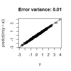

This is actually to be expected, not just with random forests, and comes about as a consequence of the fact that the variance of the target variable = the variance of the model (the estimates) + the variance of the residuals (for least-squares type fitting procedures.) Given that the latter is positive, unless your model fits perfectly, it must be that the variance of the model < the variance of the target variable. As a result, the prediction vs. actual plot can't lie on the 45-degree line passing through 0; if it did, the variance of the target variable would be equal to the variance of the model, and there would be no room left for residual variance.
Here are four plots to illustrate this point with linear regression. In the first one, the error variance is relatively high, and, as a consequence, the predicted - vs - actual plot isn't anywhere near the diagonal line. In the second through fourth, the error variance is much lower, and the predicted - vs - actual plot gets much closer to the diagonal line.
First, the code:
x <- rnorm(1000)
y <- x + rnorm(1000,0,2) # rnorm(1000,0,1), rnorm(1000,0,0.5), rnorm(1000,0,0.1)
plotlim <- range(y)
plot(predict(lm(y~x))~y,ylim=plotlim,xlim=plotlim)
abline(c(0,1))
Now, the plots:
enter image description here enter image description here enter image description here enter image description here
Consequently, there's no need to alter your fitting procedure or augment your model.
Further heuristic explanation: Note that this comes about because $\sigma^2_Y > \sigma^2_X$, in this particular linear regression model. Therefore, even with the true parameter values (in this case, 0 intercept and 1 slope), the plot of $Y$ will be more spread out than the plot of $X$, and, since the estimated values of $Y$ with the true parameter values will equal $X$, it will also be the case that the plot of $Y$ will be more spread out than the plot of the estimated values of $Y$. As a result, the estimated values vs. true values plot will not lie on a 45-degree line.
