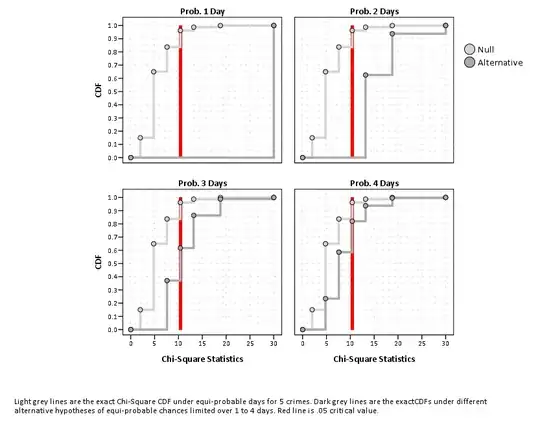

Also from the set of all potential combinations you can generate the distributions under various alternative hypotheses, and this allows you to evaluate the power of the test under those circumstances. So for example for $5$ crimes, the exact $\chi^2$ distribution has a $.05$ critical value at $10.4$. So for an alternative hypothesis of data having positive probability in only two days, you have 100% power (i.e. the only observable $\chi^2$ values if 5 crimes occur in 2 or fewer days of the week is over $10.4$).
The image below shows the CDFs for the exact $\chi^2$ distribution with $5$ crimes in $7$ weekday bins (in light grey lines), CDFs for different alternative hypotheses in dark grey lines, and the critical value $\chi^2$ highlighted with a red guideline. The alternative hypotheses are for differing numbers of days that are equi-probable for the crimes to occur on for $1$ to $4$ days during the week.
You can see from this chart even for an alternative of equi-probable chances over three days for just 5 crimes the power is just under 40%, 1 minus the CDF of the alt. hypothesis where it intersects the critical value. (Earlier I wrote that a tie goes to rejecting the null, but that would be incorrect as the Type 1 error would be inflated to .39 instead of .02 in my 3 crimes example.)
