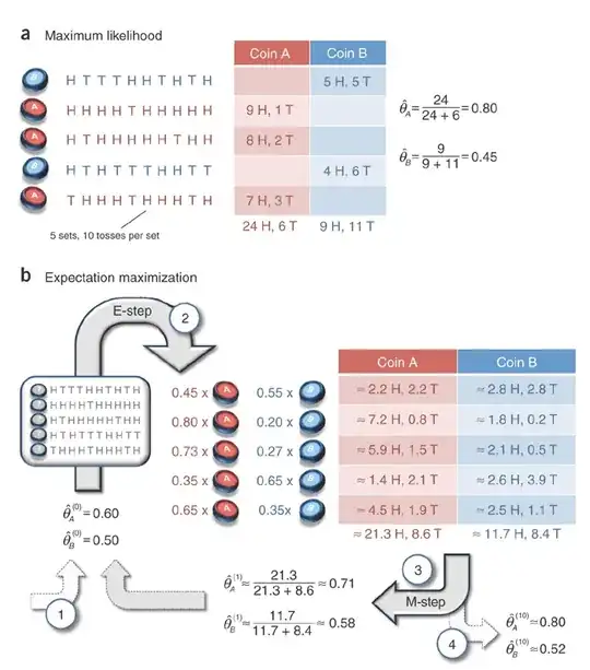

This is a recipe to learn EM with a practical and (in my opinion) very intuitive 'Coin-Toss' example:
  1. Read this short EM tutorial paper by Do and Batzoglou. This is the schema where the coin toss example is explained:
  2. You may have question marks in your head, especially regarding where the probabilities in the Expectation step come from. Please have a look at the explanations on this maths stack exchange page.
  3. Look at/run this code that I wrote in Python that simulates the solution to the coin-toss problem in the EM tutorial paper of item 1:

    # 1st:  Coin B, {HTTTHHTHTH}, 5H,5T
    # 2nd:  Coin A, {HHHHTHHHHH}, 9H,1T
    # 3rd:  Coin A, {HTHHHHHTHH}, 8H,2T
    # 4th:  Coin B, {HTHTTTHHTT}, 4H,6T
    # 5th:  Coin A, {THHHTHHHTH}, 7H,3T
    # so, from MLE: pA(heads) = 0.80 and pB(heads)=0.45

Zhubarb

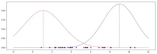

EM is useful in Catch-22 situations where it seems like you need to know $A$ before you can calculate $B$ and you need to know $B$ before you can calculate $A$.
The most common case people deal with is probably mixture distributions. For our example, let's look at a simple Gaussian mixture model:
You have two different univariate Gaussian distributions with different means and unit variance.
You have a bunch of data points, but you're not sure which points came from which distribution, and you're also not sure about the means of the two distributions.
And now you're stuck:
  • If you knew the true means, you could figure out which data points came from which Gaussian. For example, if a data point had a very high value, it probably came from the distribution with the higher mean. But you don't know what the means are, so this won't work.
  • If you knew which distribution each point came from, then you could estimate the two distributions' means using the sample means of the relevant points. But you don't actually know which points to assign to which distribution, so this won't work either.
So neither approach seems like it works: you'd need to know the answer before you can find the answer, and you're stuck.
What EM lets you do is alternate between these two tractable steps instead of tackling the whole process at once.
You'll need to start with a guess about the two means (although your guess doesn't necessarily have to be very accurate, you do need to start somewhere).
If your guess about the means was accurate, then you'd have enough information to carry out the step in my first bullet point above, and you could (probabilistically) assign each data point to one of the two Gaussians. Even though we know our guess is wrong, let's try this anyway. And then, given each point's assigned distributions, you could get new estimates for the means using the second bullet point. It turns out that, each time you do loop through these two steps, you're improving a lower bound on the model's likelihood.
That's already pretty cool: even though the two suggestions in the bullet points above didn't seem like they'd work individually, you can still use them together to improve the model. The real magic of EM is that, after enough iterations, the lower bound will be so high that there won't be any space between it and the local maximum. As a result, and you've locally optimized the likelihood.
So you haven't just improved the model, you've found the best possible model one can find with incremental updates.
This page from Wikipedia shows a slightly more complicated example (two-dimensional Gaussians and unknown covariance), but the basic idea is the same. It also includes well-commented R code for implementing the example.
In the code, the "Expectation" step (E-step) corresponds to my first bullet point: figuring out which Gaussian gets responsibility for each data point, given the current parameters for each Gaussian. The "Maximization" step (M-step) updates the means and covariances, given these assignments, as in my second bullet point.
As you can see in the animation, these updates quickly allow the algorithm to go from a set of terrible estimates to a set of very good ones: there really do seem to be two clouds of points centered on the two Gaussian distributions that EM finds.

thetaA = 0.71301, thetaB = 0.58134
thetaA = 0.74529, thetaB = 0.56926
thetaA = 0.76810, thetaB = 0.54954
thetaA = 0.78316, thetaB = 0.53462
thetaA = 0.79106, thetaB = 0.52628
thetaA = 0.79453, thetaB = 0.52239
thetaA = 0.79593, thetaB = 0.52073
thetaA = 0.79647, thetaB = 0.52005
thetaA = 0.79667, thetaB = 0.51977
thetaA = 0.79674, thetaB = 0.51966
thetaA = 0.79677, thetaB = 0.51961
thetaA = 0.79678, thetaB = 0.51960
thetaA = 0.79679, thetaB = 0.51959
Final result:
Java code follows below:

    Since the coin-toss experiment posed in this article is a Bernoulli trial,
    use a binomial probability Pr(X=k; n,p) = (n choose k) * p^k * (1-p)^(n-k).
    private static double binomialProbability(int n, int k, double p)
        double q = 1.0 - p;
        return nChooseK(n, k) * Math.pow(p, k) * Math.pow(q, n-k);
    private static long nChooseK(int n, int k)
        long numerator = 1;
        for (int i = 0; i < k; i++)
            numerator = numerator * n;
            n--;
        long denominator = factorial(k);
        return (long)(numerator / denominator);
    private static long factorial(int n)
        long result = 1;
        for (; n >0; n--)
            result = result * n;
        return result;
    Entry point into the program.
    public static void main(String argv[])
        // Create the observations and initial parameter guess
        // from the (Do and Batzoglou, 2008) article.
        List<Observation> observations = new ArrayList<Observation>();
        observations.add(new Observation("HTTTHHTHTH"));
        observations.add(new Observation("HHHHTHHHHH"));
        observations.add(new Observation("HTHHHHHTHH"));
        observations.add(new Observation("HTHTTTHHTT"));
        observations.add(new Observation("THHHTHHHTH"));
        Parameters initialParameters = new Parameters(0.6, 0.5);
        EM em = new EM(observations, initialParameters);
        Parameters finalParameters = em.run();
        o.printf("Final result:\n%s\n", finalParameters);
