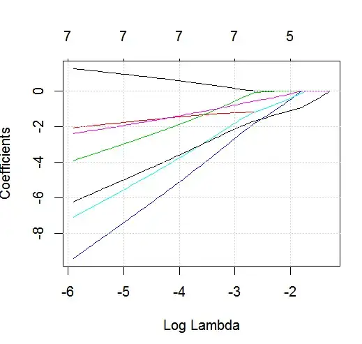

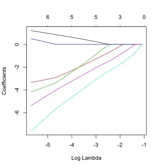

glmmod <- glmnet(x, y=as.factor(asthma), alpha=1, family="binomial")
# Plot variable coefficients vs. shrinkage parameter lambda.
plot(glmmod, xvar="lambda")
Categorical variables are usually first transformed into factors, then a dummy variable matrix of predictors is created and along with the continuous predictors, is passed to the model. Keep in mind, glmnet uses both ridge and lasso penalties, but can be set to either alone.

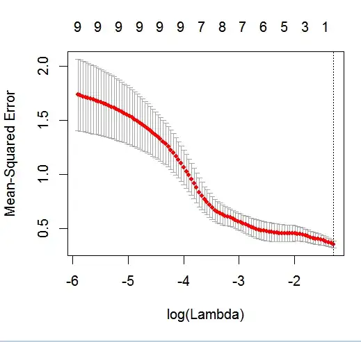

Lastly, cross validation can also be used to select lambda.
cv.glmmod <- cv.glmnet(x, y=asthma, alpha=1, family="binomial")
plot(cv.glmmod)
(best.lambda <- cv.glmmod$lambda.min)
# [1] 0.2732972

    this is exactly what I was looking for +1, the only questions I have are 1) what can you do with the cross validation lambda of 0.2732972? and 2) From the glmmod, are the selected variables favorite color (yellow), gender, and father's education (bachelor's degree)? Thanks so much! – Matt Reichenbach Oct 09 '13 at 14:21
  • Cross validation is used to choose lambda and coefficients (at min error). In this mockup, there is no local min (there was a warning also related to too few obs); I would interpret that all coefficients were shrunk to zero with the shrinkage penalties (best model has only intercept) and re-run with more (real) observations and maybe increase lambda range. 2) Yes, in the example where I chose coef(glmmod)[,10]... you choose lambda for the model via CV or interpretation of results. Could you mark as solved if you felt I solved your question? thanks.

  • In the last part, where you use cv to find the best lambda. What would I do with that lambda?, because glmmod is enough for making predictions right? – iamdeit Jan 11 '17 at 22:08
  • Why MSE for binary response variable? Isn't it wrong? – Shahin May 19 '18 at 14:08
