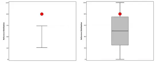

Another popular alternative to showing distributions are box plots (or error bar charts). The error bars in the left chart covers the middle 80% of the reference distribution, and the box plot on the right plots the interquartile range within the grey bar and outside of the whiskers are typically considered to be a robust estimate of outliers.
These are potentially suspect to the rote worrying you noticed though - everything is fine if within the bars and the sky is falling if it is outside. Depending on how well the reference distribution is estimated, you could plot letter values beyond the interquartile range, or plot a continuous density strip to show the reference distribution. Below is an example of a continuous gradient, where the darker grey symbolizes a higher PDF for the reference distribution. (See 40 years of boxplots by Wickham & Stryjewski.)
