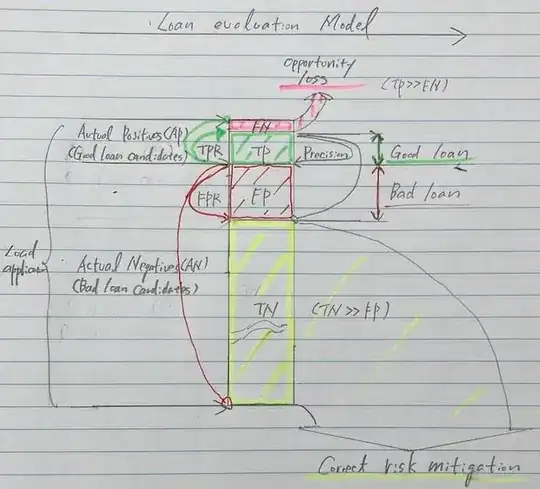

Suppose I run a loan business. The total loan applications are sum of good loan applicants (AP) and bad applicants (AN). I find good applicants (TP) and give the loan but miss some good ones (FN). Likewise, I reject bad applicants (TN) but make mistakes and cause bad loan (FP).
The performance of my business will be measured with:
  1. TPR to have correctly identified TP and maximized profit (gain).
  2. 1-FPR to have correctly identified TN and minimized loss.
  3. TP volume (profit) > FP volume (loss), otherwise I go bankrupt by debt excess.
ROC/AUC measures 1 and 2 which are ratios, however it does not tell 3. Hence I need 3 which is what Precision can tell.
Hence, in my opinion, we need both ROC/AUC and Precision/Recall to measure the model performance. However, under the condition that we know that AP and AN are more or less balanced, TPR/FPR can also indicate the Precision, hence we can omit Precision/Recall.
I suppose the reason why we wonder ROC or P/R is we may not be clearly aware of such conditions when we studied the Confusion Matrix, ROC, PR, and F1.
