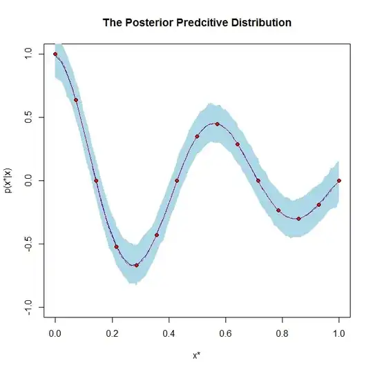

If it helps, is an example graph of a posterior distribution and a posterior predictive distribution:
    That posterior predictive distribution graph needs new axis labels and a caption or something. I get the idea because I know what a posterior predictive distribution is, but someone who's just figuring it out could get seriously confused. – Cyan Sep 25 '13 at 20:24
  • Thanks @BabakP could you also point me to what what distribution you used to plot the pmf of theta, and P(x*|theta) – A.D Sep 26 '13 at 03:42
  • ...cause I would like to work out the full example. – A.D Sep 26 '13 at 03:48
  • I just pretended that my posterior was a Beta(3,2). I did not actually work out anything. But of course, if you want an example, assume the likelihood is a Binomial(n,p) and the prior on p is a Beta(a,b) then you should be able to obtain that the posterior is once again a beta distribution. –  Sep 26 '13 at 05:03
  • As well, that posterior predictive is not an easy one to derive. I just grabbed a graph from some Gaussian Process code I wrote for a GP posterior predictive. And with that said, that posterior and that posterior predictive plot above does not actually correspond to the posterior shown, they are both arbitrary. –  Sep 26 '13 at 05:04
