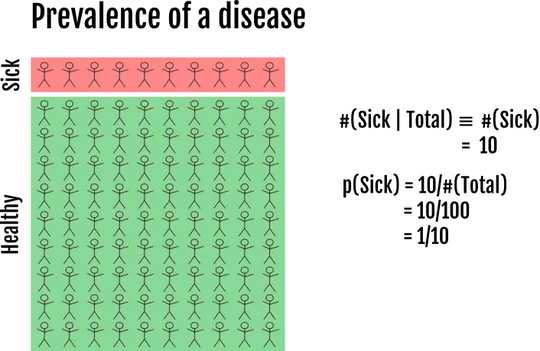

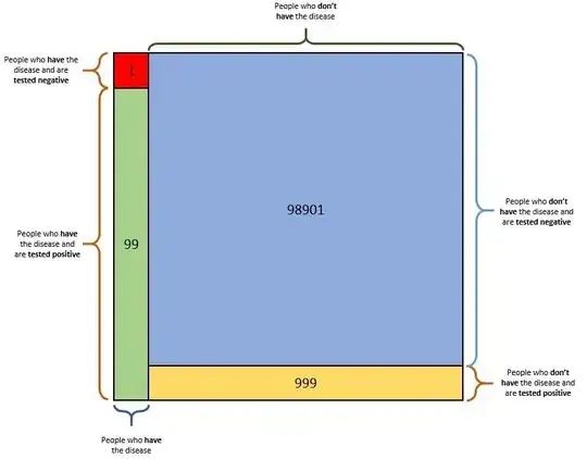

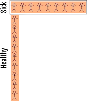

This Jan 10 2020 article on Medium explains with just one picture! Presume that
- A rare disease infects only $1/1000$ people.
- Tests identify the disease with 99% accuracy.
If there are 100,000 people, 100 people who have the rare disease and the rest 99,900 don’t have it. If these 100 diseased people get tested, $\color{green}{99}$ would test positive and $\color{red}{1}$ test negative. But what we generally overlook is that if the 99,900 healthy get tested, 1% of those (that is $\color{#e68a00}{999}$) will test false positive.
Now, if you test positive, for you to have the disease, you must be $1$ of the $\color{green}{99}$ diseased people who tested positive. The total number of persons who tested positive is $\color{green}{99}+\color{#e68a00}{999}$. So the probability that you have the disease when you tested positive is $\dfrac{\color{green}{99}}{\color{green}{99}+\color{#e68a00}{999}} = 0.0901$.

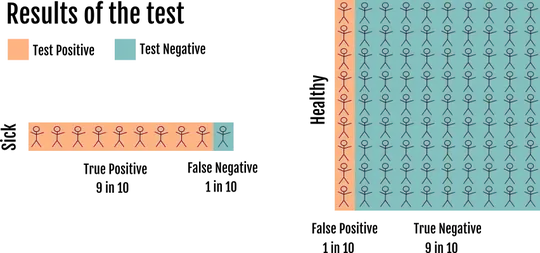

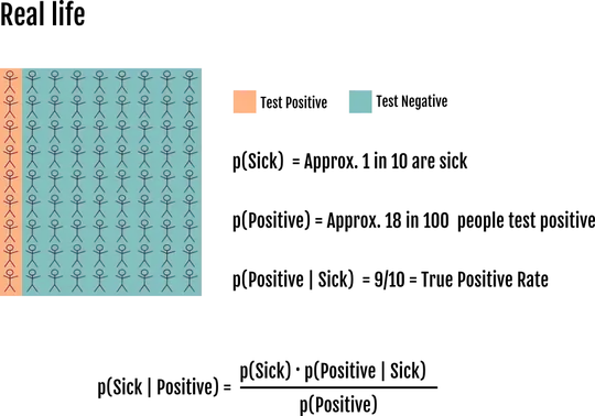

Let’s use the following example, where 1 in 10 people are sick. We denote [sic] could write p(Sick | Total population) = the probability of being sick given that you study the whole population = 0.1. But in the case when you study the whole population you just write p(Sick).
To simplify the example we assume that we know which ones are sick and which ones are healthy, but in a real test you don’t know that information. Now we test everybody for the disease:
The number of positive results among the sick population (#(Positive | Sick) is 9. These people are the true positives, a value that it’s known for tests:
#(Positive | Sick) = 9

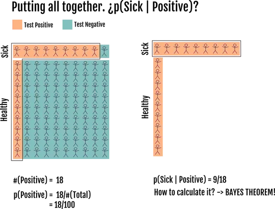

p(Positive | Sick) = 9/#(Sick) = 9/10 = True Positive RateNow the interesting question, what is the probability of being sick if you test positive? (in math: p(Sick | Positive))
In the figure above we have all the information, and therefore we can count the sick people among the positive results to say that the probability of being sick if you tested positive is 9/18 = 50%. However in real life you only know that 18/100 have tested positive. To know that 50% of those are false positives you can use the Bayes Theorem. But we will derive it here. All the information we know is:
To remind you, we want to calculate the people inside the square #(Sick | Positive).
The intuition is that if we know that there are 10 sick people (#(Sick)) and the true positive rate is 0.9, then #(Sick | Positive) = 9.
In math:
For the probability we divide among the studied population (the positive results) to get:
But we don’t know exactly how many people are sick, only the probability, so we can divide both parts of the fraction by the #(Total) and get probabilities of being sick and of testing positive.
And you have successfully derived the Bayes Theorem!
