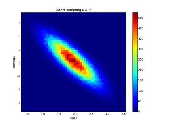

I did a naive direct sampling with this simple code in Python:
import random
import numpy as np
import pylab
def uncreg(x, y, xu, yu, N=100000):
    out = np.zeros((N, 2))
    for n in xrange(N):
        tx = [s+random.uniform(-xu, xu) for s in x]
        ty = [s+random.uniform(-yu, yu) for s in y]
        a, b = np.linalg.lstsq(np.vstack([tx, np.ones(len(x))]).T, ty)[0]
        out[n, 0:2] = [a, b]
    return out
if __name__ == "__main__":
    P = uncreg(np.arange(0, 8.01), np.arange(0, 16.01, 2), 0.1, 6.)
    H, xedges, yedges = np.histogram2d(P[:, 0], P[:, 1], bins=(50, 50))
    pylab.imshow(H, interpolation='nearest', origin='low', aspect='auto',
                 extent=[xedges[0], xedges[-1], yedges[0], yedges[-1]])
and got this: Histogram of direct sampling results
Of course you can mine the P for the data you want, or change the uncertainty distributions.
