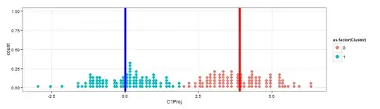

Where the two big blobs are the KMeans centres, and I have added the line that passes through the two points. If you perpendicularly project each point onto that line, then you can view the distribution of the points around each centre like so:
KMeans dots graphs
Where I have marked on the location of the means with the thick lines. The second graph can be drawn regardless how many dimensions you are working in, and is a way of seeing how well separated the clusters are.
