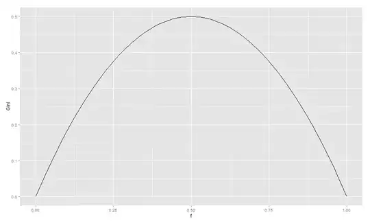

The Gini index (impurity index) for a node $c$ can be defined as: $$ i_c = \sum_i f_i \cdot ( 1- f_i) = 1 - \sum_i f_i^2$$ where $f_i$ is the fraction of records which belong to class $i$.
If we have a two class problem we can plot the Gini index varying the relative number of records of the first class $f$. That is $f_1 = f$ and $f_2 = f - f_1$.
We have very high impurity when the class distribution is uniform.
