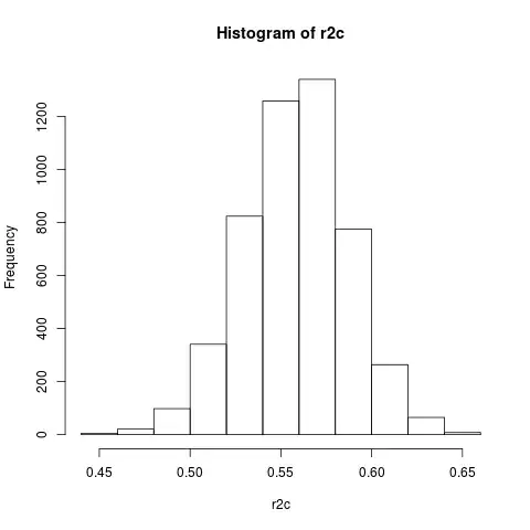

A simulation in R suggests both $r_{XZ}$ and $r_{YZ}$ are distributed quite symmetric around the mean of 0.5 instead of 0 (note these are sample correlation coefficients):
require(foreach)
snp1 = foreach(i=1:5000, .combine='cbind') %do% {
    sample(0:2, 1000, replace=T, prob=c(.81, .18, .01))
snp2 = foreach(i=1:5000, .combine='cbind') %do% {
    sample(0:2, 1000, replace=T, prob=c(.64, .32, .04))
collsnp = (snp1 + snp2 > 1) + 0
r1c = foreach(i=1:5000, .combine='c') %do% {
    cor(snp1[, i], collsnp[, i])
r2c = foreach(i=1:5000, .combine='c') %do% {
    cor(snp2[, i], collsnp[, i])
hist(r1c)
hist(r2c)

    The correlation coefficients are numbers, not random variables, and therefore do not have distributions. They are properties of the joint distribution of $(X,Y,Z)$. As to your last question: the distribution of $Z$ is determined by a single number, say $\Pr(Z=1)$. This depends on four independent values that determine the distributions of $X$ and $Y$ (say, $p_1, p_2, q_1, q_2$). Therefore you can recover one algebraic relationship among these four parameters from knowledge of $Z$, but that's all. – whuber Aug 28 '13 at 20:10

for the correlation coefficient. It can range anywhere from $0$ (approached in the limit as $p_1=p_2=1/2$ and $q_1=q_2=1/2-e^2$ for which it equals $\frac{e}{\sqrt{1-e^2}} \to 0$ as $e\to 0$) through $1$ (set $p_1=0, p_2=1/2, q_1=0, q_2=0$ for instance). Setting (as in the code of the question) $p_1 =q_1= 0.18, p_2 =q_2= 0.01$ gives $\rho_{X,Z} = 0.46308$ and $p_1= q_1 = 0.32, p_2=q_2 = 0.04$ gives $\rho_{X,Z} = 0.564433.$
