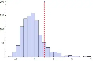

Here is a histogram of the natural logarithms of 1000 independent estimates of the KL divergence. Each estimate averages 1000 values randomly obtained from the Gamma distribution. The correct value is shown as the dashed red line.
Histogram
Histogram[Log[Table[
 Mean[Log[PDF[red, #]/PDF[gray, #]] & /@ RandomReal[red, 1000]], {i,1,1000}]]]
Although on the average this Monte-Carlo method is unbiased, most of the time (87% in this simulation) the estimate is too low. To make up for this, on occasion the overestimate can be gross: the largest of these estimates is 18.98. (The wide spread of values shows that the estimate of 1.286916 actually has no reliable decimal digits!) Because of this huge skewness in the distribution, the situation is actually much worse than I previously estimated with the simple binomial thought experiment. The average of these simulations (comprising 1000*1000 values total) is just 1.21, still about 25% less than the true value.
