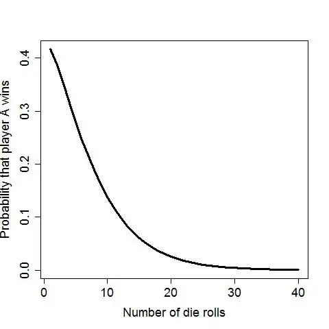

Below this is plotted as a function of $n$. In this example, it's intuitive that the probability of $A$ winning quickly goes to zero as $n$ increases since their maximums become increasingly likely to both be six, in which case $B$ wins.
$ \ \ \ \ \ \ \ \ \ \ \ \ \ \ \ \ $enter image description here
