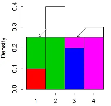

2) "Squaring the histogram" method; this is kind of related to (1), but each cell can actually generate either one of two values, depending on a (continuous) uniform. So you generate a discrete value from 1 to n, then within each one, check whether to generate its main value or its second value. It works with bounded random variables. There's no spillover table, and it generally uses much smaller tables than method (1). Usually, it's set up so that the choice of 1:n uses the first few bits of a uniform random number, and the remainder of it tells you which of the two values for that bin to output.
Perhaps the easiest way to outline the method is to do it on the above example:
Think of the distribution as a histogram with 4 bins:
original 'histogram'
We cut off the tops of the tallest bars and put them in the shorter ones, 'squaring it off'. The average 'height' of a bar will be 0.25. So we cut 0.15 off the second bar and put it in the first and 0.05 off the fourth and put it in the third:
'squaring off' the histogram
Its always possible to organize this in such a way that no bin ends up with more than 2 colors, though one color may end up in several bins.
So now you choose one of the 4 bins at random (requires 2 random bits off the top of a uniform). You then use the remaining bits to specify a uniformly distributed vertical position and compare with the break between colors to work out which of two values to output. While very fast it's usually not quite as fast as the 'table' method.
