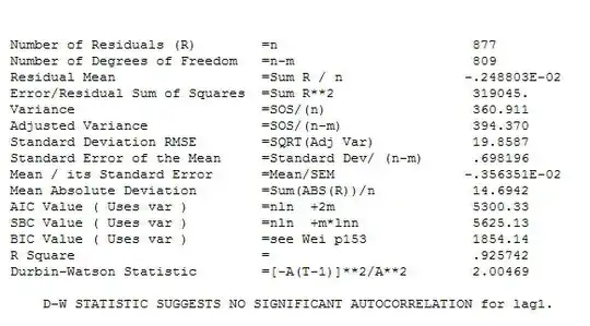

EDIT: As OP requested I present here a typical analysis. I took one if the busier hours and developed a daily model. In a complete analysis all 24 hours would be developed and also a daily model in order to reconcile the forecasts. Following is a partial list of the model enter image description here . In addition to the significant regressors (note the actual lead and lag structure have been omitted ) there were indicators reflecting the seasonality , level shifts , daily effects , changes in daily effects , and unusual values not consistent with history. The model statistics are enter image description here . A plot of the forecasts for the next 360 days is shown here enter image description here . The Actual/Fit/Forecast graph neatly summarizes the results enter image description here .When faced with a tremendously complex problem (like this one!) one needs to show up with a lot of courage , experience and computer productivity aids. Just advise your management that the problem is solvable but not necessarily by using primitive tools. I hope this gives you encouragement to continue in your efforts as your previous comments have been very professional, geared towards personal enrichment and learning. I would add that one needs to know the expected value of this analysis and use that as a guideline when considering additional software. Perhaps you need a louder voice to help direct your "directors" towards a feasible solution to this challenging task.
After reviewing the Daily Totals and each of the 24 Hourly Models , I would definitely reflect that the Number Of Visits is in a serious downslide ! This kind of analysis by a prospective buyer would suggest a non-purchase while a seller would be wise to redouble their efforts to sell the business based upon this very negative projection.
