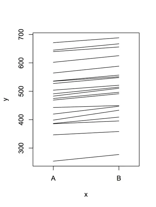

Take a simple multi-level model of a two level repeated measures design. Let's say you have the following data where each line is a subject:
In lmer the model could be expressed as:
y ~ x + (1|subject)
You're predicting the y-value from x as a fixed effect (the difference between A and B); and the intercept a random effect**. Look carefully at the graph and note that while there is variability in the x effect for each subject (each line's slope) it's relatively small compared to the variability across subjects (the height of each line).
The model parses these two sets of variability and each one is meaningful. You can use the random effects to predict heights of lines and you can use fixed effects of x to predict slopes. You could even use the two combined to work our individual y-values. But what you can't do is really say anything meaningful with respect to your model when you combine the variability of slopes and heights of lines together. You need to talk about the variability of your slopes and heights of lines separately. That's a feature of the model, not a liability.
You will have a variability of the effect of x that's relatively easily estimated. You could say something about a confidence interval around that. But note that, this confidence interval is going to have small relation to the prediction of any particular y value because the y value is influenced by a combination of effect and subject variance that's different from the variability of the effect alone.
When Bates writes things like you've quoted I imagine he's often thinking of much more complex multi-level designs that this doesn't even approach. But even if you just consider this simple example you come down to wondering what kind of real meaning can be extracted from combining all of the variance measures together.
