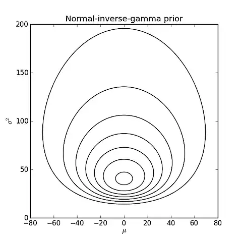

For $P(\mu, \sigma^2 \mid M = \text{Normal})$ I choose a normal-inverse-gamma distribution with parameters $m_0 = 0, v_0 = 20, a_0 = 1, b_0 = 100$.
