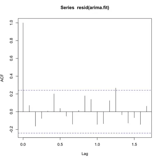

So far so good. I have performed residual analysis for both models, and here is the confusion.
The acf(resid(fit1)) looks great, very white-noisey:
acf of fit1

Either I am not understanding the test, or it is slightly contradicting to what I see on the acf plot. The autocorrelation is laughably low.

If you are judging with ACF then fit 1 is more appropriate. Instead of being confused on Ljung test you can still use the correlogram of the residuals to ascertain the best fit between fit1 and fit2

According to the ACF graphs, it is obviously that the fit 1 is better since the correlation coefficient at lag k(k>1) drops sharply, and close to 0.
