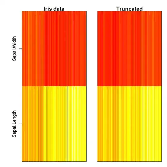

The second example is an svd on only the first two columns of iris, thus the reconstruction is also only going to have two columns. The reconstruction again uses the single leading PC:
dat <- as.matrix(iris[,-c(3:5)])
s <- svd(dat)
plot(cumsum(s$d^2/sum(s$d^2))) # % explained variance
pc.use <- 1
recon <- s$u[,pc.use] %*% diag(s$d[pc.use], length(pc.use), length(pc.use)) %*% t(s$v[,pc.use])
x11(6,6)
par(mfcol=c(1,2), mar=c(1,1,1,1), oma=c(0,3,1,0))
zlim=range(dat, recon)
image(dat, zlim=zlim, yaxt="n", xaxt="n", ylab="", xlab="", main="Iris data")
axis(2, at=seq(0,1,,ncol(dat)), labels=colnames(dat))
image(recon, zlim=zlim, yaxt="n", xaxt="n", ylab="", xlab="", main="Truncated")
    Marc, I am confused where the dimensionality reduction is occurring. In the first example, we still end up with 4 columns and while the second example results in 2 columns, it only used the first two columns of iris - which is a feature selection, not a dimensionality reduction. I expected SVD to give a similar result as a PCA, where the full data is used, but less than the original number of columns results. – B_Miner Jul 15 '13 at 15:51
    The truncation occurs by only using a subset of the PCs (in the example, only the 1st one), but the reconstructed data has the same dimensions as the original. – Marc in the box Jul 15 '13 at 20:26
