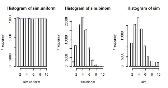

Here are plots of draws from two such components (with the parent distributions marked in blue) and from the mixture. The binomial consists of $\pi = 4/5$ of the mixture here.
Histograms
The component histograms closely match their parents, indicating they were correctly simulated. The histogram of the draws from the mixture (at right) should look like a weighted mixture of the two component histograms, which it does. We may more precisely compare these using a scatterplot:
Scatterplot
Yes, they agree (to within sampling error). The algorithm appears to be working correctly.
