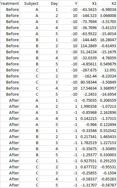

i created a toy example data below to give readers a sense of the data structure. Y is the continuous, dependent variable. I know that the standard deviation of Y of the subjects in the "Before" Treatment group is much higher than that in the "After" Treatment group.
And my goal is to identify the factors that can explain the higher variability of Y in the "Before" treatment.
Which regression model is suitable for this ? And do I have to melt / aggregate the dataframe ?

    Avoid adding code, data or output as images for these reasons. In R (not sure you use R), there are several ways to provide data, probably adding the output of dput(<yourData>) to your question is easiest. Also explain what situation your toy data is suppose to represent. For example, what does it mean that patient A has a before measurement and after measurement on days 1, ..., 5? – dipetkov Feb 22 '24 at 10:40
  • Did you look at the answers to https://stats.stackexchange.com/questions/505490/regression-with-variance-as-outcome ? – David B Feb 22 '24 at 15:17
  • There is a clear, single factor fully explaining the differences in variability of $Y:$ Before vs. After. Indeed, $Y$ appears to be expressed on two different scales that can be made commensurate simply by dividing all the "Before" values by 10. – whuber Feb 25 '24 at 14:49
  • @dipetkov, my apologies. The data are randomly generated. So even if you plug the data into any model, nothing meaningful will be produced. – user1769197 Feb 28 '24 at 02:47
Your situations combines multiple features that make this a bit trickier than usual, namely that you want to model differences in distribution parameters (also known as distributional regression) and that you have multiple measurements per subject (repeated measures). You should somehow reflect that observations from the same subject are likely somehow correlated (in the example below I allow for completely unstructured covariance matrix), for which you could choose a MMRM (mixed effects model for repeated measures). The default implementation thereof (e.g. in the mmrm R package or PROC MIXED in SAS) would let you estimate different covariance structures (and let you constrain them to have the same variance for each day, if you want) for the two groups, but would not let you model explanatory factors for the variance. That's mostly a lack of flexibility of existing software rather than a theoretical problem, but at least the brms R package lets you do this (the below assumes DAY and Treatment are factor variables):

  • I have no idea if that's what the OP intended but a patient is measured twice a day under both treatments. What does the model imply for the correlation between: two Y's on the same day; two Before Y's on consecutive days; one Before and After Y on two consecutive days (all for the same patient)? – dipetkov Feb 23 '24 at 19:23
  • Yes a patient is measured twice a day and we can consider the two Y's on the same day are independent. 2 Before Y's on consecutive days can also be considered independent. And one Before and After Y on two consecutive days is also considered to be independent for all patients.
    And it seems like you are suggesting using mixed effect model to study the variance /covariance of the parameters? Sorry I am not familiar with bayesian approach at all.
    – user1769197 Feb 28 '24 at 03:00
  • Can I ask which part of the regression output would indicate how much a particular input feature X is causing higher variability of Y ? – user1769197 Feb 28 '24 at 03:42
