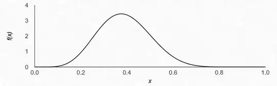

Just for a visual representation: let's define $\alpha = 1$, $\beta = 1$, $n = 16$, $x = 6$
if $c = 0.5$:
c = 0.5
if $ c = 1 $ c = 1
if $c = 3$: c = 3
    This is something I've often wondered about. But notice that what's changing with the scaling factor $c$ is not the prior, but the likelihood. – John Madden Feb 13 '24 at 16:15
    Your comment made me notice that the transformation looks like $\pi(\theta | X) \propto (L(X|\theta))^c \cdot (P(\theta))$. I also researched a bit, and in the more general case Multinomial-Dirichlet, it can also be expressed as the Likelihood to the power $c$, but I don't know if it is just a nice coincidence, or if it has indeed a meaning. – Oscar Flores Feb 15 '24 at 09:39
    We (i.e. the stats research community) are also still trying to determine the exact meaning of such a transformation. For more info check out "power priors". – John Madden Feb 15 '24 at 21:13
