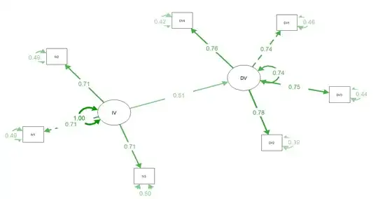

Your independent variable appears to be a composite of three items which is supposed to represent something intangible (e.g. anxiety, socioeconomic status) and four DVs which may also represent some intangible. Specifically, the items are manifest variables because they are directly observable and the intangibles or the constructs you are trying to capture are latent variables because they are indirectly observed variables via the manifest variables.
I feel the most obvious solution to your problem is some kind of structural equation model (SEM), where the IV latent variable is regressed on the DV latent variable. Here is an overly simplified simulation of your data (some of what I write here is a bit lazy but still demonstrates what I am trying to convey). I simulate the data in R and fit the model with the lavaan package, which is a common package for SEM.

The plot below shows the constructed model (unlabeled):
The circles represent the latent variables (IV and DV) and the squares are the items that represent them, or the manifest variables. The lines drawn between the circles and squares are regression paths which estimate how much each item "loads" onto the latent variable, or essentially how close it relates to the latent variable. The semi-circle arrow paths are the variances for each.
That information isn't easy to see, so I change the code here. The standardized loadings are shown below, where each number on the arrows represents how much each item "loads" onto the latent variable. You can see that the arrow between the IV and DV represents the regression path, which shows that the relationship between the two is $\beta = .51$, which is very close to what we specified in our simulated data:

The full model summary can be run with summary(fit, fit.measures = T), which I do not go into detail here, but examining them is a necessary part of fitting these models:
