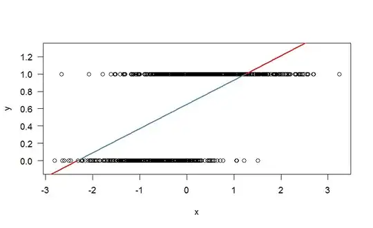

IllFit
As you can see, a linear line is fitted through the data. One problem of this is that the line predicts outcomes that are outside the interval $[0,1]$ (illustrated by the red lines outside that interval). Let's have a look at the residuals:

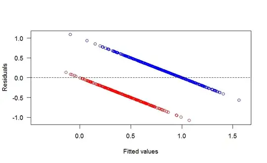

I randomly picked some values to show the pattern. The red and blue lines are depicting the residuals, which is the difference between the predicted value of the line and the actual observed value (red and blue dots). The blue lines correspond to the residuals where $y=1$ whereas the red residuals correspond to the situation where $y=0$. Because the outcome can only be either 0 or 1, the residuals are simply the distances between the regression line and either 0 or 1. The residuals take exactly the form that you see in your data:
# Plot the residuals
res.linear <- residuals(linear.mod, type="response")
par(bg="white", cex=1.2)
plot(predict(linear.mod)[y==0], res.linear[y==0], las=1,
     xlab="Fitted values", ylab = "Residuals",
     ylim = max(abs(res.linear))*c(-1,1), xlim=c(-0.4, 1.6), col="red")
points(predict(linear.mod)[y==1], res.linear[y==1], col="blue")
abline(h = 0, lty = 2)
IllModelResidualplot
The colors correspond to the residuals shown above: the blue dots are the residuals where $y=1$ and the red dots are the residuals where $y=0$. In normal linear regression, the residuals are assumed to be approximately normally distributed. But in this case, the residuals can hardly be normal. They are binomial.
