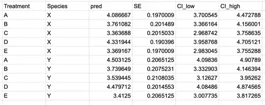

Here were the results: Results from manually computed CIs

The results were different enough (no significant pairwise comparisons) that it changes my conclusions substantially.

  • Ok I updated with the CIs from emmeans vs. manually computing – mels Nov 28 '23 at 20:36
    The emmeans confidence intervals are t-based, not Z. Use qt(.975, 9) $\approx$ 2.262 (for df=9) or 2.571 (for df=5) where you used 1.96 (cmult) and they should match. I do want to reiterate EdM's point that the confidence intervals of the marginal means do not say much about the difference between them - non-overlap is a much more stringent requirement than the CI of their difference excluding zero. – PBulls Nov 28 '23 at 21:06
  • After correcting your code as indicated by @PBulls, nothing is stopping you from constructing a confidence interval around any linear combination you like: the calculations are the same. Using the full covariance matrix accounts for the correlations among the estimates. (There may be an issue of computing the df for the t-statistics, though, depending on which combinations you are using and what the model formula is.) – whuber Nov 28 '23 at 21:15
  • Thank you! @PBulls, that makes sense and does make the CIs more similar between the two methods, though not exact. I think I'll stick to using emmeans since it is a more established method. – mels Nov 29 '23 at 20:41
The point estimates and standard errors agree perfectly between the two methods, and the confidence limits calculated the two ways are very similar (probably due to the difference between z- based and t-based intervals, as in a comment from @PBulls).
