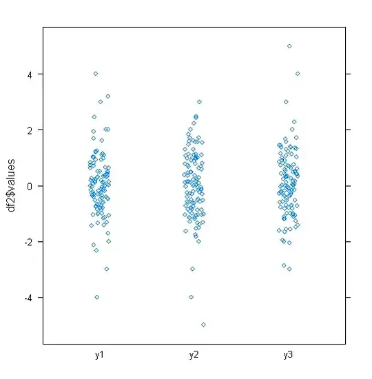

Personally I like to use a stripplot with jitter at least to get a feel for the data. The plot below is with lattice in R (sorry not ggplot2). I like these plots because they're very easy to interpret. As you say, one reason for this is that there isn't any transform.
df <- data.frame(y1 = c(rnorm(100),-4:4), y2 = c(rnorm(100),-5:3), y3 = c(rnorm(100),-3:5))
df2 <- stack(df)
library(lattice)
stripplot(df2$values ~ df2$ind, jitter=T)
The beeswarm package offers a great alternative to stripplot (thanks to @January for the suggestion).
beeswarm(df2$values ~ df2$ind)
With your data, as it's approximately normally distributed, another thing to try might be a qqplot, qqnorm in this case.

    I like stripplots too, but the question is explicitly about what to do with heavy-tailed distributions. – Nick Cox Jul 03 '13 at 10:57
  • @NickCox I would still use stripplots here as a first cut. I'd definitely be interested in other answers though, as I have come across similar problems to the OP in the past. – TooTone Jul 03 '13 at 10:59
    The point is just that the advice to use e.g. qqnorm does not match the question. Other kinds of quantile-quantile plots could, I agree, be a very good idea, as I mentioned earlier. – Nick Cox Jul 03 '13 at 11:03

    Even better than stripplots from R are the plots from the beeswarm package. – January Jul 03 '13 at 14:06
    @January Yeah that's pretty cool, I'm adding it to my answer (if you object please say so). – TooTone Jul 03 '13 at 14:25
  • I believe the motivation behind @Nick Cox's comments is that all the methods presented in this answer are seen to be unhelpful when applied to heavy-tailed data: they all produce clusters of points at one end of the plot (or, in the case of Q-Q plots, a nearly horizontal line) and one or a few sparse points at the other end, merely confirming what was known at the outset: a tail is heavy. An effective solution would both reveal the heaviness of the tails and effectively resolve the main mass of data. – whuber Jul 03 '13 at 14:38
  • @Whuber Thanks for trying to summarize. Sometimes one does needs a graph showing the clustering explicitly. To go beyond that, one often needs something else. I don't think there can be a universal solution e.g. if there are zeros logarithms are often a bad idea, although some people are happy to fudge to log(x + 1). – Nick Cox Jul 03 '13 at 14:41
  • @Whuber thanks for explaining further. I'd welcome an answer from either you or Nick. – TooTone Jul 03 '13 at 15:07
