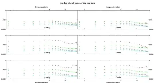

First, here are some visual representations of the data sets just to show you guys what kind of data am I talking about. I am posting both the data in its original form without any kind of transformation and then its visual representation in log-log space as it clarifies some of the data's features while distorting others. I am posting a sample of both good and bad data.
good data log-log good data bad data log-log bad data
Each of the six panels in each figure show four data sets plotted together red, green, blue, and cyan and each data set has exactly 20 data points. I am trying to fit each one of them with a straight line plus a gaussian because of the bumps seen in the data.
The first figure is some of the good data. The second figure is the log-log plot of the same good data from figure one. The third figure is some of the bad data. The fourth figure is the log-log plot of figure three. There is much more data, these are just two subsets. Most of the data (about 3/4) is good, similar to the good data I showed here.

The data where we see two sets, we very heavily prefer to capture the first bump at around 4-5 mHz. So I don't want to add more gaussian terms and our gaussian term should be centered on the first bump which is almost always the bigger bump. We want "more accuracy" between 0.8mHz and around 5mHz. We don't care too much for the higher frequencies but don't want to ignore them completely either. So maybe some sort of weighing? Or B can be initialized around 4.8mHz always?
