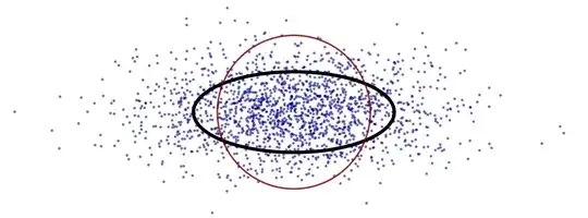

Here's an example showing the 60% covering ellipse in a scenario where $\sigma_x=2.5\sigma_y$. The red circle has radius = $\sqrt{\sigma_{xy}^2}$ and covers 65% of sample points. Example of covering ellipse and circle

    I'm not so sure that circle always overcovers? At least empirically it seems to slightly undercover if $\sigma_x$ and $\sigma_y$ differ by >2 orders of magnitude. I'm also not so convinced there would be a straightforward generalization, because the two axes are arbitrarily independent - solved by the ellipse - and the circle re-introduces a fixed dependence. – PBulls Oct 18 '23 at 04:58
  • @PBulls: I can't find an example where that circle undercovers. For example: if $\sigma_x=1000, \sigma_y=1$ then R(0.5, 707) covers 60% of samples, not 50%. – feetwet Oct 18 '23 at 13:54
  • Hmm, but for the same case R(0.8) covers 0.795 here. Increasing $p$ also increases the deficit. – PBulls Oct 18 '23 at 14:00
    I played around with some simulations over the parameter space: https://imgur.com/a/woF0TGR. The different green lines are increasing ratios of variances away from the identity line, it goes 1.5, 2, 3, 5, 10 up to 100 but past 10 there's little absolute difference. Through sheer luck $p=0.8$ is roughly the point where it goes from over to under, but even that point depends on the ratio (it decreases slightly as ratio increases). Anyway, to me this proves that you'll definitely have to account for this variance ratio in some way. – PBulls Oct 18 '23 at 14:28
