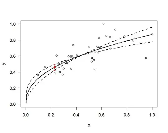

I hope you can help me get some confidence in my confidence interval... I am trying to get the confidence interval for a particular (threshold) point on a predicted curve.
I find the confidence interval (C.I.) looks funny, so I would like to know whether what I am doing is correct... Thank you for any advice you can give me!
#Here is the data to which I fit a nonlinear least squares regression (power function)
y <-c(0.5745373, 0.8255836, 0.7139635, 0.6318004, 0.8688738, 0.8341626, 0.9278573, 0.6548638,
0.6995722, 0.8410211, 1.0000000, 0.8512973, 0.7917790, 0.5722589, 0.6918069, 0.7117084,
0.5279689, 0.6121315, 0.5869292, 0.7332605, 0.5991816, 0.5470566, 0.5987166, 0.4440854,
0.3719892, 0.4394820, 0.4410862, 0.4966288, 0.4291826, 0.4221613, 0.3951223, 0.3595973,
0.4617549, 0.5106482, 0.5939970, 0.5340835, 0.6036920, 0.5181577, 0.3892170, 0.3667581)
x <- c(0.95149254, 0.57954545, 0.56763699, 0.57089552, 1.00000000, 0.66870629, 0.70833333,
0.53125000, 0.58776596, 0.78061224, 0.61551724, 0.63750000, 0.85000000, 0.52397260,
0.66870629, 0.50328947, 0.52192982, 0.40691489, 0.36016949, 0.37500000, 0.35915493,
0.53968254, 0.36334197, 0.23486842, 0.19615385, 0.35961538, 0.30039267, 0.26424870,
0.54838710, 0.23363874, 0.26936620, 0.09514925, 0.15324519, 0.32465278, 0.33909574,
0.31587838, 0.24401914, 0.28813559, 0.23181818, 0.29272959)
plot(x,y, xlim=c(0,1), ylim=c(0,1))
m1 <- nls(y~a*x^b, start=list(a=2,b=0.2))
summary(m1)
curve((0.86888*x^0.43042), add=TRUE)
points(0.2276312,0.4595148, col='red', pch=17) # this is the threshold value I
                                               # previously calculated
now I would like to know the Confidence Interval of the threshold
#lower CI
0.86888-(2*0.04578) # intercept minus 2* S.E.
0.43042-(2*0.06333) # exponent minus 2*S.E.
curve((0.77732*x^0.30376), add=TRUE) # plot the lower C.I.
0.77732*0.2276312^0.30376 # Now I enter the x coordinate of threshold point in the
# Confidence interval function, to get the y coordinate
points(0.2276312,0.4958526, col='red', pch="-", cex=1.5) # plotting the CI of threshold value
#Upper CI
0.86888+(2*0.04578) # intercept plus 2* S.E.
0.43042+(2*0.06333) # exponent plus 2*S.E.
curve((0.96044*x^0.55708), add=TRUE) # plot upper C.I.
0.96044*0.2276312^0.55708 # Now I enter the x coordinate of threshold point in the
points(0.2276312,0.4211113, col='red', pch="-", cex=1.5) # plot the CI of threshold value
lines(c(0.2276312,0.2276312),c(0.4211113,0.4958526), col="red")
# then check whether correct
confint(m1) # more or less, but slightly different, don't understand why?
nls confints
To me, a C.I. that looks like this would make more sense...
curve((0.96044*x^0.30376), col="green",add=TRUE)
curve((0.77732*x^0.55708), col="green",add=TRUE)
NLS_confint2
but that would be mixing the intercept of upper and exponent of lower C.I. and vice versa
My question is then, are the black Confidence Intervals correct (and thus the thresholds red confidence interval?

  • Re the edit (and introduction of graphs): you seem to want prediction limits rather than confidence limits. Please search our site for a discussion of the distinctions. – whuber Jul 17 '13 at 13:56
  • yes, you are right i think. I want to predict the interval in which the threshold will fall. As the threshold is a calculated, single point on the predicted curve, it seems I have to talk about prediction limits... – EHR Jul 17 '13 at 16:43

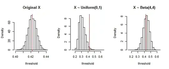

Example scenarios
Here are results for three distributions of $X$: the original one (in which the $x_i$ never vary), a uniform distribution, and a Beta distribution that approximates the distribution of the original data. $10^4$ iterations were used.
Histograms
Each plot marks the estimated threshold $\hat{t}$ with a vertical red line. Because that line is centered on the "Original X" histogram, we deduce there is little bias and can take the extreme values of this histogram as approximate confidence limits for $t$: roughly from $0.412$ to $0.433$ (95% confidence).
The second and third plots show how exquisitely sensitive $\hat{t}$ is to the distribution of the $x_i$ and how biased an estimator it might be: notice how much wider the range of threshold is on their horizontal axes. In the second plot, where it is likely the smallest $x_i$ is close to $0$ and the largest $x_i$ might be substantially less than $1$, the reference slope ("secant") is relatively high, pushing the estimated threshold to the left where the curve has greater slopes. The bias is large, approximately $+0.12$, merely because the largest $x_i$ in the dataset is $1$ and the smallest, $0.095$, is fairly far from zero. In the third plot the bias has disappeared (!) but the range of estimated thresholds is still wide. A symmetric 95% confidence interval for $t$ is $[0.33, 0.52]$ (based on $10^4$ iterations). I suspect the lack of bias may be a bit of luck because the $x_i$ are centered fairly close to the original $\hat{t}$. This can be confirmed by drawing the $x_i$ from other distributions, such as a Beta(4,1) distribution (centered near $2/3$): the bias is now $-0.21$.
This is about as far as we can reasonably take the analysis without knowing more about how the $x_i$ are determined. The results are interesting insofar as they reveal how important it is to understand how the data arise: there is a huge range of answers available here, all of which are consistent with the numbers, but only some of which could be appropriate for what actually occurred during this study.

R code to produce these results follows. (Change n.iter to obtain other than $10^3$ iterations.)
# Fit a curve y = a*x^b to the data using nonlinear least squares,
# compute the "threshold," and return its value.
# (Called by `sim`.)
fit <- function(x, y, a=1, b=0.5) {
  m <- nls(y ~ a * x^b, start=list(a=a, b=b))
  coeff <- m$m$getPars()
  f <- function(x) coeff[1] * x^coeff[2]
  fp <- function(x) coeff[1] * coeff[2] * x^(coeff[2]-1)
  x.min <- min(x)
  x.max <- max(x)
  secant <- (f(x.max) - f(x.min)) / (x.max - x.min);
  threshold <- uniroot(function(x) fp(x) - secant, c(0,10^6))$root #$
  return(threshold)
# Perform a bootstrap simulation with the specified model:
# `n` is the number of iterations
# `f` is the original estimated curve (as a vectorized function)
# `e` is the array of residuals to the initial fit (it defines an empirical
#     distribution of residuals)
# `alpha` and `beta` are parameters for a Beta distribution of the x[i]
# `x` is the array of x[i] to use when not simulating the x[i].
sim <- function(n = 1000, f, e, alpha=1, beta=1, x=NULL) {
  replicate(n, {
    if (is.null(x)) {
      x.0 <- rbeta(length(e), alpha, beta)
    } else {
      x.0 <- x
    y.0 <- f(x.0) + sample(e, length(e), replace=TRUE)
    fit(x.0, y.0)
# Obtain the initial fit.
m1 <- nls(y ~ a * x^b, start=list(a=1, b=0.5))
# Compute the residuals `e` and the curve function `f`.
e <- residuals(m1)
coeff <- m1$m$getPars()
# Prepare to bootstrap and plot several scenarios.
# Each scenario should take 2-3 seconds for n.iter=1000.
par(mfrow=c(1,3))
n.iter <- 10^3
b <- seq(0.15, 0.65, 0.025)
set.seed(17)
# Scenario 1: keep the x values fixed.
threshold <- sim(n.iter, f, e, x=x)
hist(threshold, main="Original X", freq=FALSE)
abline(v = fit(x, y), col="Red")
quantile(threshold, c(0.025, 0.975)) # A symmetric CI
# Scenario 2: vary the x values uniformly in [0,1].
threshold <- sim(n.iter, f, e, alpha=1, beta=1)
hist(threshold, main="X ~ Uniform(0,1)", freq=FALSE, breaks=b)
quantile(threshold, c(0.025,0.5, 0.975))
# Scenario 3: vary the x values according to Beta(4,4).
threshold <- sim(n.iter, f, e, alpha=4, beta=4)
hist(threshold, main="X ~ Beta(4,4)", freq=FALSE, breaks=b)

  • @ whuber;thanks for your help. 3 last questions, hope you have the time and energy to help me with! Would you be able to answer – EHR Jul 27 '13 at 13:59
  • why a semi-parametric vs. a parametric bootstrap? 2) I was also wondering whether choosing the third scenario (Scenario 3: vary the x values according to Beta(4,4)) is preferred over the other two, i.e. what are the benefits of selecting this one over the others. My guess is that using the distribution of my original data will result in a confidence interval that is more representative of reality. Also the confidence intervals appear somewhat larger and thus a little bit more precautionary... 3) what does Beta(4,4) indicate?
