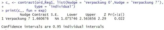

Below the summary statistics and a contrast for Nudge 0 and Nudge 7. Why are the results different?
Below the code I have written that produced above results (and more plots). It might be useful to others.

    By giving a single list() to contrast you are asking for predictions. You need to give it 2 list for differences or 4 lists for double differences (and ratios of odds ratios). If you omit an interacting factor from a list() you’ll get a difference at the median (if continuous) or mode (if categorical) level of the unnamed interacting factor. – Frank Harrell Oct 11 '23 at 12:49
