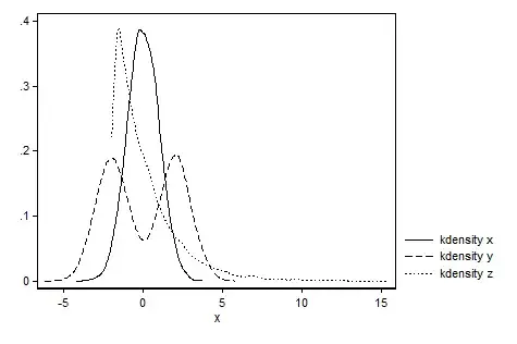

As an aside: With a t-test you are not testing whether the samples are equal, but only whether or not the means are equal. Below is a silly example using Stata: the three variables x, y, and z are clearly from different distributions, but we (correctly) cannot reject the hypothesis that the means are equal.
. clear
. set obs 10000
obs was 0, now 10000
. gen x = rnormal()
. gen u = runiform()
. gen y = (u <  .5)*( rnormal() - 2 ) + ///
>         (u >= .5)*( rnormal() + 2 )
. gen z = rchi2(2) - 2
. twoway kdensity x || ///
>        kdensity y || ///
>        kdensity z
. ttest x = y, unpaired unequal

. ttest x = z, unpaired unequal
Two-sample t test with unequal variances
Variable |     Obs        Mean    Std. Err.   Std. Dev.   [95% Conf. Interval]
       x |   10000   -.0169198     .010027    1.002698   -.0365747    .0027351
       z |   10000    .0086713    .0198435     1.98435   -.0302259    .0475686
combined |   20000   -.0041242    .0111166    1.572121   -.0259136    .0176652
    diff |           -.0255912     .022233               -.0691705    .0179882
    diff = mean(x) - mean(z)                                      t =  -1.1510
Ho: diff = 0                     Satterthwaite's degrees of freedom =  14792.6
    Ha: diff < 0                 Ha: diff != 0                 Ha: diff > 0
 Pr(T < t) = 0.1249         Pr(|T| > |t|) = 0.2497          Pr(T > t) = 0.8751
