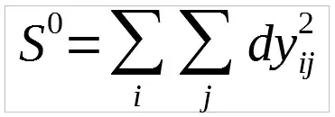

The hard part is finding $A$. After plugging in the minimizing value of $B$, the function to be minimized is: enter image description here, where
where $dx_{ij} = x_{ij} – mean_j(x_{ij}), dy_{ij}=y_{ij} – mean_j(y_{ij})$

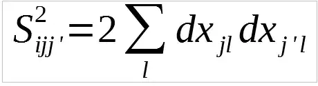

This is a quadratic function in the entries of $A$. It attains its minimum precisely at its critical point(s). To find those, condense the $S^2_{ij}$ and $S^2_{ijj'}$ into a single $nm\times nm$ matrix:
Here we think of the pair of indices $ij$ as if it were a single index via a bijection between pairs of integers in $[1,n]\times [1,m]$ and integers in $[1,nm]$. Then minimizing values of $A$ are exactly given by solutions to the equation $S^2\vec{A}=-\frac{1}{2}S^1$, where $S^1$ is a column vector storing the $S^1_{ij}$ in the order given by that bijection and $\vec{A}$ is $A$ collapsed down to a single $nm$-length column vector via that same bijection.
$S^2$ is always positive semidefinite. If it is positive definite, then we're in the nice case of a single optimal solution $\vec{A}=(S^2)^{-1}(-\frac{1}{2}S^1)$. But if not, then I suppose we might get a positive-dimensional set of optimal solutions.
So my question is: Is there a nice theorem, preferably with a clear statistical interpretation, to tell when that matrix is not invertible? And can it be derived from the formulas above? Something analogous to the one-variable case, where the least-squares line breaks down iff var(X)=0, i.e. all the datapoints have the same input value.
