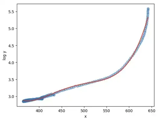

Edit: @Durden suggested that I consider modeling the relationship as a log-linear model. That looks like that is indeed helpful, as you can see the fit on a 4th order polynomial between x and log y is very good.
    Your dependent variable $y$ looks like an exponential function of $x$. Have you tried a log-linear regression? – Durden Aug 05 '23 at 14:17
  • @Durden, thank you. Helpful suggestion. I've added a plot which shows the fit between x and log y. That might be a fruitful approach. Still have the question above, but certainly performing this transformation first might help. – gammapoint Aug 05 '23 at 14:52
