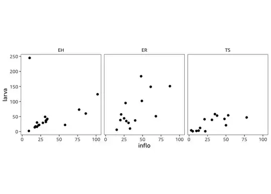

Let's start by plotting the data. We can do better than a boxplot by showing larva against inflo by modality.
We learn lots from these three scatterplots:
  • There is a linear relationship between inflo and larva, so the model should include inflo as an offset. (You have already done this.)
  • The counts are overdispersed, esp. for the ER modality. A Poisson model won't be appropriate for this data; instead consider a quasipoisson model or a negative binomial model.
  • The dispersion (ie. the variance) is different for the different modalities. For example, even by eye, ER has about twice as much variability than EH.
  • There is an outlier in the EH subset. You should check whether this might be a data entry issue.
  • But even more intriguingly, there seems to be a shift in the rate above inflo = 50 or so. If we ignore the outlier, notice how a straight line that fits the points below inflo = 50 will pass above the observations for inflo = 50. Something might have happened during the experiment or else there might be something that happenes to larva when the inflo is too high? There are few observations collected at high inflo, so the data can't tell what's going on.
So to summarize: The data suggests to consider a quasipoisson or a negative binomial model and model the dispersion as well as the mean rate as a function of modality. Since modality is a factor variable, I make a first stab at this analysis by fitting three separate models, one for each modality. I fit both the quasipoisson and the negative binomial regression; the results are similar.
Note: I remove the outlier before I do the analysis.

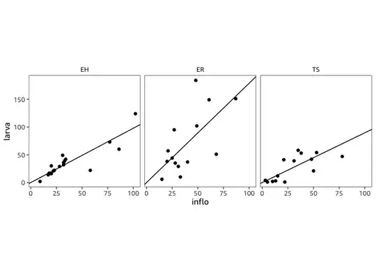

And finally, the data (with one "unusual" data point removed) and with the mean rate estimated by the quasipoisson regression. The model for the EH modality is not a great fit: notice how the line does its best to fit the observations for low inflo (< 50) and high inflo (> 50) with the end result that it fits neither particularly convincingly.
R code to reproduce the analysis and the figures:

mydata %>% ggplot( aes(inflo, larva) ) + geom_point() + facet_grid( ~modality ) + geom_abline( aes(intercept = 0, slope = estimate, group = modality), data = mus.qp )

  • Thank you for your feedback. I was well aware of the overdispersion (I was thinking of using the NB model) and the presence of the outlier for the EH modality. However, you raised two interesting points that I hadn't noticed before: 1) the different response pattern before and after inflos = 50, and 2) the difference in the dispersion parameter between the three modalities. – Isa Gre Jul 30 '23 at 12:34
  • My concern is how can I deal with this? To model the dispersion as a function of modality, you fit 3 models. But in this case, how do I get the p-value that gives the significance of the modality effect? Can I get it from the 3 fitted models or can I fit a single model where the dispersion parameter depends on modality? With the fit3_offset model I would do this: library(car) Anova(fit3_offset, test="LR") fit_emm <- emmeans(fit3_offset, specs=c("modality"), type="response", offset = log(1)) contrast(fit_emm, method = "pairwise", adjust="tukey") %>% summary(infer = TRUE) – Isa Gre Jul 30 '23 at 12:35
  • (Caveat: Personally I think significance tests and p-values are not very informative, so take this with a grain of salt.) (a) I would look at the confidence intervals; they tell us something about each modality. Isn't confidence intervals what you are getting with emmeans as well? (b) I got interested as well about how to do the "different-dispersions-in-one-model" analysis. This CV thread suggests VGAM for standard analysis and brms for Bayesian analysis. I haven't tried it though. – dipetkov Jul 30 '23 at 12:47
  • However, I expect that since modality is a categorical variable, you would get very similar results with the "three separate models" approach and the "estimate the mean rate and the dispersion for each modality in one big model" approach. On the other hand, if you had other variables (covariates), I would expect a bigger model to be a better choice because the big model would learn about the effects of the covariates from the entire dataset. – dipetkov Jul 30 '23 at 12:51
  • For point 2, the only solution would be to fit one model for inflos <50 and a second for inflos >50 and test the modality effect for both situations? – Isa Gre Jul 30 '23 at 13:07
  • This question is tricky. Note that I "eyeballed" 50 and only from the EH subset; I observed a pattern in the data and wanted to highlight it. For a purely statistical solution what I would ask is: Can the relationship between inflo and larva vary smoothly (now it's a line and we only estimate its slope). But if I were you, I would be instead thinking about it from the science perspective like this: Is there a possible scientific explanation/mechanism for this? Should I collect more data at high inflo? What about the other 2 modalities? etc. – dipetkov Jul 30 '23 at 13:33
  • Maybe I was a bit extreme when I wrote "not particularly convincingly" and it's better not to change your model for the relationship between inflo and larva in this analysis (it's just 4 points and there is an outlier as well). But think instead about what you learned from this experiment and what experiment you might want to do next. – dipetkov Jul 30 '23 at 13:33
  • To be clear of what I think is the main conclusion from this experiment: the data are consistent with the rate for EH and TS being not much different and the rate for ER is higher than either EH or TS. – dipetkov Jul 30 '23 at 13:37
