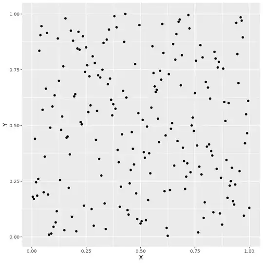

The margins are $U(0, 1)$.
The joint distribution shows dependence.
Independence would look more like this.
You can create this by using sample(y) in the df_scatter, which breaks the dependence structure by scrambling the y values.
(I’ve actually used a concept from copulas to create this example, and readers will be able to pick up on it if they know copulas and the ecdf function, though the key point is that, regardless of how I created the joint distribution, the margins are uniform yet dependent.)
