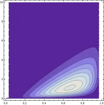

Example
Let $F$ be the distribution function for a Beta$(4,2)$ variable $X$ and $G$ the distribution function for a Gamma$(2)$ variable $Y$. By using the preceding construction we can form the joint distribution $H$ with a Gaussian copula and marginals $F$ and $G$. To depict this distribution, here is a partial plot of its bivariate density on $x$ and $y$ axes:
Plot
The dark areas have low probability density; the light regions have the highest density. All the probability has been squeezed into the region where $0\le x \le 1$ (the support of the Beta distribution) and $0 \le y$ (the support of the Gamma distribution).
The lack of symmetry makes it obviously non-normal (and without normal margins), but it nevertheless has a Gaussian copula by construction. FWIW it has a formula and it's ugly, also obviously not bivariate Normal:
$$\frac{1}{\sqrt{3}}2 \left(20 (1-x) x^3\right) \left(e^{-y} y\right) \exp \left(w(x,y)\right)$$
where $w(x,y)$ is given by $$\text{erfc}^{-1}\left(2 (Q(2,0,y))^2-\frac{2}{3} \left(\sqrt{2} \text{erfc}^{-1}(2 (Q(2,0,y)))-\frac{\text{erfc}^{-1}(2 (I_x(4,2)))}{\sqrt{2}}\right)^2\right).$$
($Q$ is a regularized Gamma function and $I_x$ is a regularized Beta function.)
