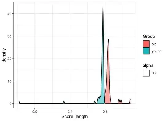

However, when I use logistic regression with leave-one-out cross validation, I obtain an AUC of 0, which implies complete separation in the logit space (though in the opposite direction, predicting old to be young and young to be old). I plotted here the density function of the predicted values (logit scores), so you can see that the Groups are indeed totally separable:
Density plot of the raw scores
This makes no sense, because the predicted values in logistic regression are supposed to be a monotonic transformation of the input. Are they not? I.e., higher score on sentence length should increase the probability of one class vs. the other, and hence increase its logit transformation as well. It can't be that from a completely uninformative variable that provides absolutely no separation between the groups, we receive perfectly separable scores. What am I missing here? How can this be?

So after thinking about this for a while, a friend suggested that this could be related to the bi-modality in the data (or rather, the fact that there is more than one "peak" in the density plot), because when he log-transformed the data he did not get AUC=0 (though still not close to 0.5).
To test this hypothesis, I synthesized a dataset drawn from a random bi-modal distribution, and I randomly assigned 'A' and 'B' labels such that there is no real group difference:

When I run LOO-CV on this random data, and plot the predicted scores (y-axis) against the original values (x-axis), I get a very weird pattern. While it is clear that there is no separability on the x-axis (original variable), we can draw a line that perfectly separates the two groups on the y-axis (logit scores):
And indeed, AUC=0 (or AUC=1, depending on the hypothesis; since my original one resulted in AUC=0, I will stick to that).
