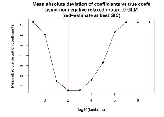

Here an example: if I regress a blurred multichannel spike train against a banded covariate matrix with time shifted copies of the known point spread function / blur kernel, enter image description here with true coefficients enter image description here I can recover the true support near-perfectly enter image description here (which is not so obvious that that should be the case if you look at the raw data) enter image description here Using a lambda chosen a priori that would maximise the GIC it can be seen that the correct support size is identified enter image description here whilst also producing unbiased coefficients enter image description here and recovering the true support perfectly accurately enter image description here (I was always told there should be a bias-variance tradeoff, but seems I can avoid it here - kind of magic)
If I do repeated fits on bootstrapped datasets & look at how the union of selected variables changes you can see that there is two plateaus, the first corresponding to the approximation of the true support (plus 3 or 4 nearly collinear variables) and a second one where false positives also start to level off (fairly quickly by the looks of it, reaching 35 out of 200 variables after 100 bootstrap replicates for a true support size of 20). enter image description here
