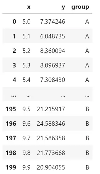

df_c = pd.DataFrame({"x": x_c, "y": y_c, "group": group_list}) df_c
df_c
