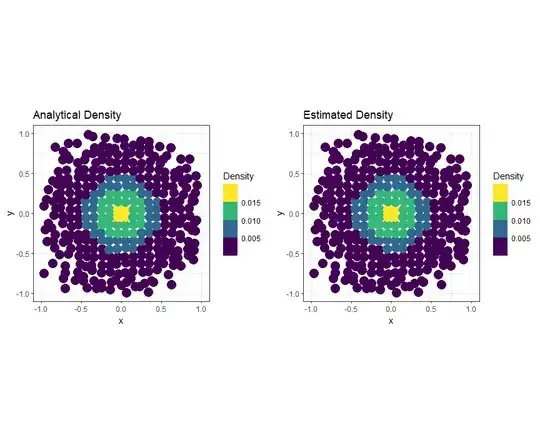

We then bin the data according to Euclidean coordinates and divide the x and y axis into bins with some equal spacing. For each bin, record the median $x,y,r,\theta$ values, and then the number of observations in each bin for a Poisson regression. In the case of the Multivariate normal I have presented above, we do not need to worry about $\theta$ because the polar representation of the the above is: $$ f(r,\theta)=\frac{1}{2\pi}r exp(-r^2/2) $$ This suggests in the log-linear regression, we need to enter $r^2$ as the relevant co-variate. Here is the implementation.

binnedData$fitted<-binnedModel$fitted.values plot(binnedData$fitted,binnedData$n) binnedData$density_est=binnedData$fitted/sum(binnedData$fitted)
For checking against the known density function in this case: take the median values we saved and compute the integral where $b$ is the binsize used for binning the data. They seem to be roughly correct.
$$ \int_{x-b}^{x+b}\int_{y-b}^{y+b} N(0,\Sigma) $$

ggplot(binnedData,aes(x=x,y=y))+geom_point(aes(colour=binnedDensities),size=5)+ scale_color_viridis_b()+theme_bw()+ggtitle('Analytical Density') ggplot(binnedData,aes(x=x,y=y,colour=density_est))+geom_point(size=5)+ scale_color_viridis_b()+theme_bw()+ggtitle('Estimated Density') plot(binnedData$density_est,binnedDensities)
  • (1) Aren't you making an extremely strong assumption not present in the question--namely, that the data are a sample of some bivariate Normal distribution? (2) Your examples do not exhibit the rotational symmetry assumed in the question. (3) Although it's nice to describe alternative methods of density estimation, the question really is interested specifically in (nonparametric) kernel density methods. (4) Why do you use Cartesian coordinates to create bins for an inherently polar problem? One can bin the polar coordinates just as well--and why bin $\theta$ at all? – whuber Apr 21 '23 at 20:53
  • @whuber Fair and good points. I made the initial bivariate normal assumption just to try and satisfy the rotational symmetry as I thought/recalled that the 0 mean isotropic bivariate normal has 0 dependence on $\theta$. This should render binning $\theta$ useless as I had done above and you have noted. The second example clearly violates this and should be removed, but I had included it for expounding on the idea. It probably adds more confusion than needed. I thought this might be an alternative to dealing with the non-negativity issue associated with the KDE in 1D. – user1848065 Apr 21 '23 at 21:34
