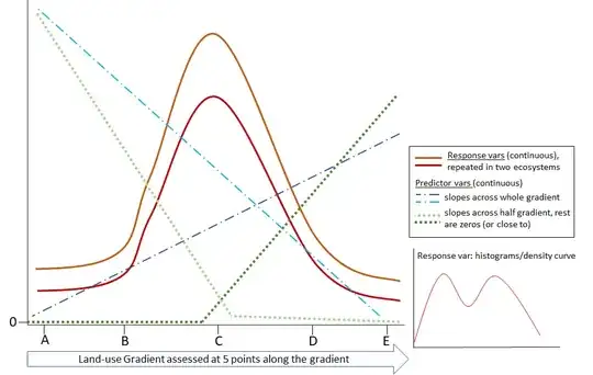

I am absolutely clueless in an analysis and hope you can help because I have nobody else to ask right now and got totally lost in four statistics books and a zillion tutorials over the past five weeks. Toy graph illustrating data and study design
And here is an overview of what I am trying to do (also see toy graph for visual aid):
  • I try modelling a continuous response variable as function of a whole bunch of predictors along a land use gradient (ie a succession of typical anthropogenic land use classes like agriculture, meadow... to unused, protected landscape)
  • I got observation plots in five land uses (A-E in the graph) along that land use gradient, replicated in two different ecosystems; the ecosystems got equal numbers of observations, only some land uses are underrepresented/unbalanced
  • there is some spatial autocorrelation as within ecosystems and land uses the oberservation plots are clumped in the landscaped
  • the two ecosystems generally have a different baseline level in the response var (orange vs darkred solid line), but the overall pattern is the same; only when plotting histograms of the response vars their distribution always looks bimodal (red solid line in small inset)
  • I would like to include the two ecosystems as a fixed factor (same for the five land uses) as I am interested in their difference, not seeking generalization across these
  • the predictors along the land use gradient are of two types: i) the ones that follow the same trend all across the gradient, some increasing, others decreasing (blue dashed lines), and ii) the ones that only have a non-zero trend across half of the gradient and are often zeros or close to zero in the other half of the gradient (green dotted lines)

  • @ Sextus: sorry for causing confusion, I amended the text above to clarify. In short: a 'plot' in my case is a rectangular bit of landscape of 50x50m and the basic observation unit in my data. A land use gradient is a common thing in ecology whereby one makes use of a naturally or anthropogenically existing gradient in the landscape to assess the impact that land use has on a certain feature; eg from the inner city (land use 'A' in my case) to outer city ('C') to the adjacent forest ('E') human pressure declines along that gradient, and so insect biodiversity tends to increase. – user_20201213 Mar 27 '23 at 08:09
  • @user_20201213 I get now what you meant by 'plots'. Now your schematic drawing is not clear to me. You draw a line, but did you measure along the entire gradient, or did you only measure in five points? So, basically you have 2 times 5 measurements, ten numbers in total? – Sextus Empiricus Mar 27 '23 at 09:04
  • What are these green and blue lines? – Sextus Empiricus Mar 27 '23 at 09:05
  • @ Sextus: You are right, I only measured at five sections along the gradient, but got 15-20 replicates at each of the five stages. The continuous red line of the response var is what I assume to be the case, yet I didn't cover all the gradient but used the five representative stages to cover it. The blue and green lines are, as I tried to explain above, simplyfied representations of the behaviour my predictor variables display along the gradient. I assessed those for each observation and use them to predict each observation's value of the response variable. – user_20201213 Mar 29 '23 at 10:01
  • @user_20201213 knowing that your measurements are just taken at 5 points (whether or not they are many replicates or not is irrelevant, the curve in your image does not represent your measurements very well) I start to wonder what your statistics question actually is. You have a bunch of data, but what is your research question that you try to answer with it? Do you have some hypothesis to test? What is the goal? – Sextus Empiricus Mar 29 '23 at 10:37
