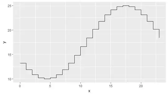

The current methods to fit a sin curve to a given data set require a first guess of the parameters, followed by an interative process. This is a non-linear regression problem. A different method consists in transforming the non-linear regression to a linear regression thanks to a convenient integral equation. Then, there is no need for initial guess and no need for iterative process : the fitting is directly obtained. In case of the function y = a + r*sin(w*x+phi) or y=a+b*sin(w*x)+c*cos(w*x), see pages 35-36 of the paper "Régression sinusoidale" published on Scribd : http://www.scribd.com/JJacquelin/documents In case of the function y = a + p*x + r*sin(w*x+phi) : pages 49-51 of the chapter "Mixed linear and sinusoidal regressions". In case of more complicated functions, the general process is explained in the chapter "Generalized sinusoidal regression" pages 54-61, followed by a numerical example y = r*sin(w*x+phi)+(b/x)+c*ln(x), pages 62-63
If you know the lowest and highest point of your cosine-looking data, you can use this simple function to compute all cosine coefficients:
getMyCosine <- function(lowest_point=c(pi,-1), highest_point=c(0,1)){
  cosine <- list(
    T = pi / abs(highest_point[1] - lowest_point[1]),
    b = - highest_point[1],
    k = (highest_point[2] + lowest_point[2]) / 2,
    A = (highest_point[2] - lowest_point[2]) / 2
  return(cosine)
Below it is used to simulate the variation of temperature throughout the day with a cosine function, by entering the hours and temperature values for the lowest and warmest hour:
c <- getMyCosine(c(4,10),c(17,25))
# lowest temprature at 4:00 (10 degrees), highest at 17:00 (25 degrees)
x = seq(0,23,by=1);  y = c$A*cos(c$T*(x +c$b))+c$k ;
library(ggplot2);   qplot(x,y,geom="step")
The output is below: Cosine computed from lowest and highest points
