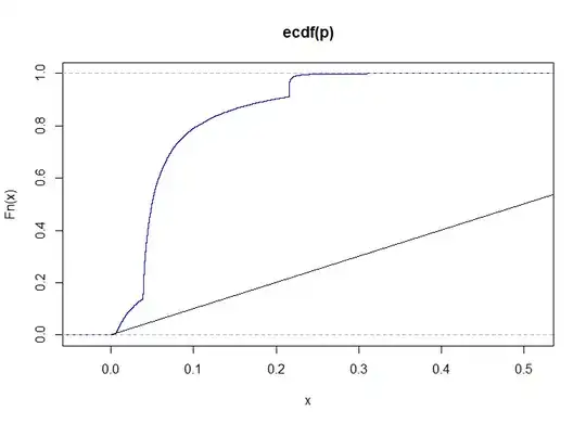

simulate 1000 KS p-values for identically distributed observations
p <- replicate( 1e3, { x <- mapply((p) rbinom(n, 1, p), seq(0.1, 0.9, length.out = k)) y <- mapply((p) rbinom(m, 1, p), seq(0.1, 0.9, length.out = k)) csy <- colSums(y) csxy <- colSums(x) + csy S <- sapply(1:k, (i) runif(1, phyper(csy[i] - 1, m, n, csxy[i]), phyper(csy[i], m, n, csxy[i]))) ks.test(S, punif)$p.value } )
plot(ecdf(p), col = "blue") lines(0:1, 0:1)
# simulate p-values when the distributions are slightly different
p <- replicate(
  1e3,
    x <- mapply(\(p) rbinom(n, 1, p), seq(0.1, 0.9, length.out = k))
    y <- mapply(\(p) rbinom(m, 1, p), seq(0.2, 0.8, length.out = k))
    csy <- colSums(y)
    S <- sapply(1:k, \(i) runif(1, phyper(csy[i] - 1, m, n, csxy[i]), phyper(csy[i], m, n, csxy[i])))
# simulate p-values when the distributions are even more different
p <- replicate(
  1e3,
    y <- mapply(\(p) rbinom(m, 1, p), seq(0.3, 0.7, length.out = k))
    csy <- colSums(y)
The final demonstration is in log-space, so as to test if $S\sim\text{exp}(1)$. (This formulation is not actually needed here, but it demonstrates how to maintain numeric stability if the proportion of observations of $D$ or $D'$ in the partition is very unbalanced).
# simulate p-values when the distributions are very different
p <- replicate(
  1e4,
    y <- mapply(\(p) rbinom(m, 1, p), seq(0.7, 0.3, length.out = k))
    csy <- colSums(y)
    S <- sapply(1:k, \(i) (a <- -phyper(csy[i], m, n, csxy[i], log.p = TRUE)) - log1p(runif(1)*expm1(phyper(csy[i] - 1, m, n, csxy[i], log.p = TRUE) + a)))
    ks.test(S, pexp)$p.value
