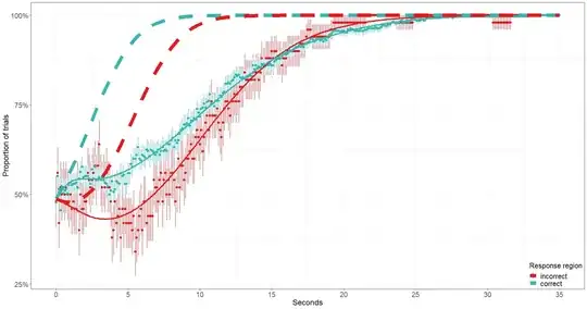

I managed to recover the formula for the model with no random effect using the procedure I described above (bold sentence; see Fig.1). However, when there is a random effect, the formula recovered directly using the summarized parameters does not produce a similar curve as the one produced by averaging individual predict() values (see Fig.2). enter image description here Fig.1 Fixed effect model. dashed lines are produced by recovered model formula. Solid lines are produced by averaging predict(). enter image description here Fig.2 Mixed effect model. dashed lines are produced by recovered model formula. Solid lines are produced by averaging predict().
I looked the coef(model) and found different nt1 for each sample, so I realized that the predict() values for each sample must be generated using individual coefficients instead of the united model coefficients. Furthermore, the averaged predict() curve even has 1 more inflection point (3 inflection points) than the model (3rd order so 2 inflection points) could possibly produce.
In this case, I doubt the possibility of recovering the formula for a mixed effect model.

  • @whuber Thanks for the conmment. I'am struggling to read the link because I don't have much knowledge of the deep math. However, when there is no random effect, I did manage to recover the model formula with the coefficients and the intercept in the summary using the procedure I described. When there is a random effect, the formula I recovered does not produce a similar curve as the one produced by averaging individual fitted() values. – Jinjin Mar 15 '23 at 00:27
